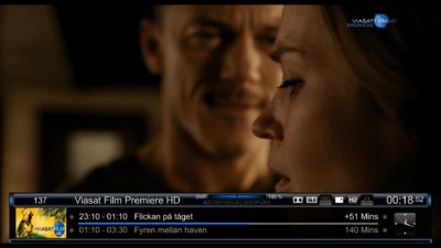

I can confirm that the viasat CI+ module (NDS) Encryptin is workin fine on VU+ Solo2 with OpenBlackhole.
I have not tested on regular BlackHole but cant see no reason why it should not work there.
All i hade to do was to Activate the modul with the Viasat Card in my Samsung series 6 UHD TV and then move all to my VU+ Solo2 and now I can see Viasat HD Channels also. so next step will be to test on regular BlackHole and then buy me a Solo4K
When you get the modul you must first activate the modul and the card in an approved TV Like my Samsung Series 6 UHD when you have everything working there just move it over to your STB go to Common Interface meny and check
that HighBitrate is set to YES
No plugin like CI+ helper is needed OpenBlackHole is working just fine as it is for me
