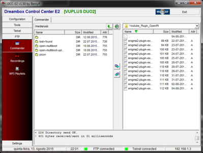

2) - I have my USB PEN DRIVE to run OpenMultiboot ... already booted 13 different images on it without issues ... and on the same pen, i´ve my <picon> files ... it´s mapped as on the guide i made as /media/usb ...
Note: If you mount allways in the same order ... i think you don´t get any issues ... If you intend to use OpenMultiboot ... use on flash OBH .... and the other images on Multiboot as on the list --> GUIDE HERE

In the guide it´s only an example ... i have an 16GB usb pen drive with only one partition ... an HDD 1TB with only one partition too.
Don´t understand why you have you HDD USB drive mounted as /media/usb .
