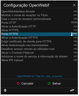

I apologize for having the settings in Portuguese ... but we are over 273 million in the world!:eek:
nAH4obm.png​
This is the configuration in OpenWebif you should have. When you do this you will be asked for the password that you will have to set:
Telnet - type passwd and hit enter; then type the chosen password and again press enter; will prompt you to rewrite the password, again hit enter.
Pay attention to the ports chosen for stream / transcoding ....
