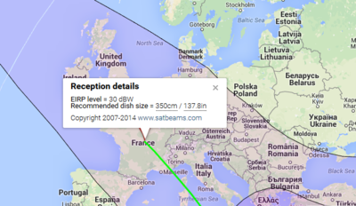

But in any case, you would need, if you live in Europe, an antenna for sat receiving, at least 350 cm diameter.
Moreover most of the channels, are transmitting using Band C ( Circular Band ), so you should have a LNB for this purpose.
In any case, here is the information of the satellite PAKSAT 1R ( 38º East ).
Reception Details
38°E — Paksat 1R Ku-band Pakistan, Central/South Asia beam
Distance to satellite:38905.6km
Location:43.07°N 0.7°W
Elevation angle:27°
LNB Tilt (skew):33.8°
True azimuth:130.4° Magnetic azimuth:--
Next Sun
azimuth match at:08:23:01 (GMT)
08:23:01 (PC time
