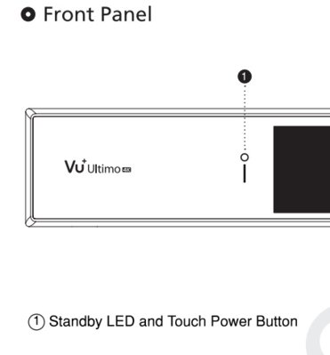

Yes I would like to load new Image but it appears in the display that I need to press the Power button, but it is difficult when the Power button is not working....
The VU+ Ultimo 4K is quite a new receiver, and I can't locate many images, or relevant information, regarding the receiver.
Is the front power button a touch screen button?

It is just a touch button, not a physical button.
You should only need a light press on it, not to "push" it.
If touching it does not put the box into standby when it is on (or bring it out of standby when you touch it) then the button is faulty and your box needs repairing / replacing.

for me to get it to work on the 4k Ultimo I have to
1) put in USB stick
2) power on at the back AND at same time press(touch) the power button on the front panel at the same time
