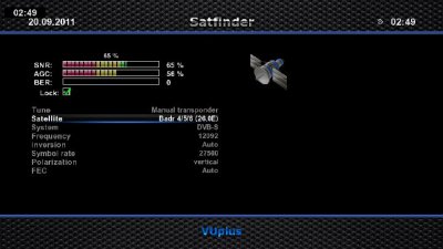

Tested 2 channels from the same transponder 12092
Both have SNR of 65% , but one of them has No pictures or No sound and sometimes it freeze or go in slow motions!
2nd channel is working normally!
So the conclusion that, the transponder providers have their own signal transmission problems!
RgdZ
