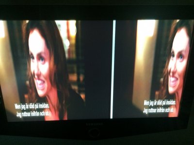

I have problem with this as well... I have HDMI connected to one tv and the Component to another tv but the one connected to Component gets a pink tone in the image. I have played around in the A/V settings and the video is when the Colour Format is RGB and the picture is when its CVBS. I had a VU+ duo connected before using exact the same setup and it worked fine but now I have upgraded to a VU+ duo2 box and I get this pink image:( When the box boot it works fine but after a wile it turns pink:(
Do anyone know what's wrong?

Set it to CVBS as this is what will change it to colour on your 2nd tv. On your HDMI tv this setting won't change anything.
