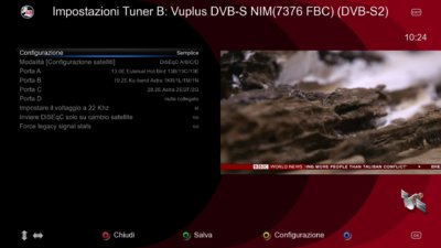

As Tururu said, we need the exact configuration of your Tuners, as mine in the attached grab.
TO grab an image from your box type the IP of your box in your PC browser followed by /grap, like
192.168.1.55/grab
for instance.
And, above all, what kind of LNB do you have: a Universal one or a Unicable/SCR?
