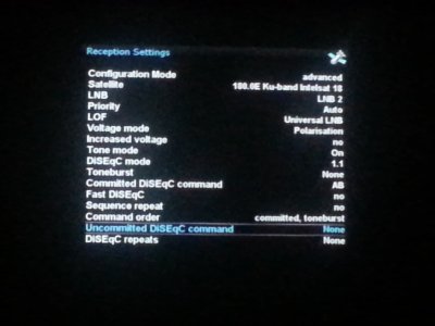

So now I've changed the cable to the LNB, the Diseqc switch, the Multiswitch and reset the box to factory standards but the problem persists and I can't scan in Intelsat 18. Like I said it worked fine last week so the box should be able to.

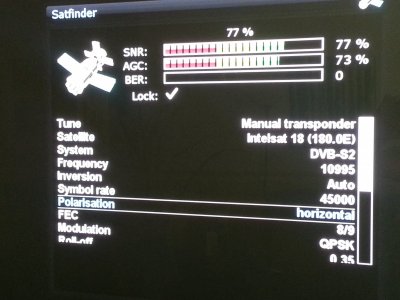

Also if I go to Sat Finder and quickly switch from vertical to horizontal I sometimes get a lock. But when I exit the sat finder and go back to try (manually or automatically) to scan that sat, there's no lock.
Attached pics of Antenna settings and Sat Finder lock
Anyone know what I'm doing wrong?
