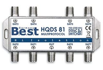

I'm trying to configure my VU+ DUO2 to work with a DiSEqC 8x1 switch (bought on amazon, brand: Germany B.E.S.T., model: 8x1 multiprotocol)

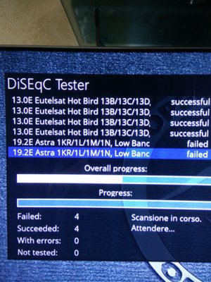

All the 4 LNBs are connected to the mentioned switch. I've tested every LNB individually (without switch) and they all got 92-99% signal.
Currently only the 1st LNB (HOTBIRD) is tuning correctly.

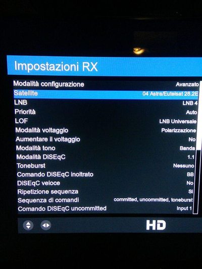

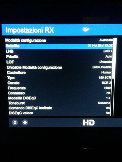

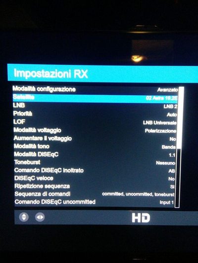

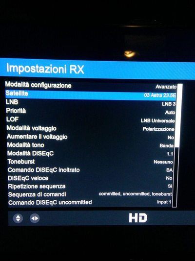

Here's the tuner configuration (sorry my receiver is in italian :( if you need a translation, just ask :) )
LNB 1 (HOTBIRD 13E) [The only one that currently works]
LNB 2 (ASTRA 19.2E)
LNB 3 (ASTRA 23.5E)
LNB 4 (ASTRA/EUTELSAT 28.2E)
The problem
I can only see channels from the 1st LNB (hotbird). Could someone please help me fixing the others LNB setup?

On your first one you have the LOF set to Unicable.

The 1st LNB (the one pointed to Hotbird 13E) is an SCR LNB.

28.2 E ---> LNB 4 (NORMAL - INVERTO)
If using only the first four tr changing the tuner to Simple, Disecq, and the play with the 4 options.
already tried every possible option. Disecq A/B/C/D, Toneburst A/B, etc... :'(

SOLVED! :)
I've disabled the "committed command" and set the "uncommitted command" to the desidered LNB :)
Eg. LNB 2, uncommited command ---> 2
It worked :) Thanks for your time, Mick
