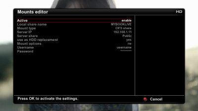

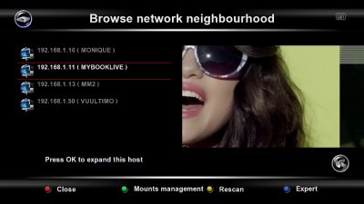

I have network drive mounted with cifs.
I have mount public folder on network drive (NO PASS and NO USER Name)

Hello
I have a vu+ uno and a Ready Nas NV+.
I have two shares from the nas mounted on the uno in CIF mode.
From what I have seen on your screen shot, you are trying to use "media" as local share name.
I believe that this is a reserved name and is already in use by the system. Try to use another local share name.
