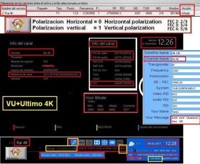

Is anyone able to find the temporary channel RAI 4K by OBH (or BH)?
12303.00MHz, pol.V SR:27500 FEC:3/4 - 8PSK
It should be on air with a fix screen announcing today night film by if I try either a manual scan by the appropriate settings or by defined transponder (after having added it to satellites.xml) it does not find anything.
Unfortunately, the blindscan does not work on Solo4K.
Try with FEC 2/3, it's there, but Nagra encrypted.

OK, this means the channel is really active. Can you attach please your satellites.xml form /etc/tuxbox, please?
I know it's crypted but I've got the regular equipment and I've been able to watch it the previous times it broadcast something.
Here you go, but I just took a look there and 12303 is not in the list.
Probably OBH feed placed one without it, during the last update few days ago.
I think you'll need to do a manual scan with above parameters.
El TP esta activo desde el 8-12-2017/The TP is active since 8-12-2017
Linea para el fichero/ Line for the file satellites.xml.
<transponder frequency="12303000" symbol_rate="27500000" polarization="1" fec_inner="2" system="1" modulation="2"/>

Yes, I had tried a manual scan but I wasn't able to find it, until I set a 2/3 FEC instead of the supposed correct 3/4. Now I got it but OBH is not able to produce anything but a light black square. I also tried BH 304, found the channel with the manual scan but it also is not able to show what's being broadcasting right now (the film Suspiria). I dislinke the horror films but it was just a curiosity because, so far, I've been able to watch Rai4K only by openpli, a year ago or so.
I hope I'll have the time to install it in OMB. I'll let you know. Meanwhile, if someone else would like to try, it'll be interesting as a feedback to BH or OBH coders.

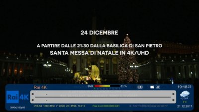

Yes, I can see it. I had read yesterday about this event and I was going to check in the next days if any sign or picture was being broadcast. Thanks for having already reminded me, so now my curiosity has been satisfied: OBH is able to get it.
Actually, there is still the last think to verify: currently they are broadcasting FTA because I'm able to watch it even without my Tivusat equipment (Tivusat reader+Gold card), despite of the encryption symbol. We'll see how they'll broadcast the event on 24th, if like now, FTA, or encrypted.
So, I can confirm it was really working but only the video, although encrypted, and regularly decrypted by Tivusat equipment.
Instead, the audio, AC3+, didn't work.
This issue about AC3+ has already been discussed in this forum but I hadn't had the chance to try myself before yesterday.

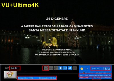

Para otra vez, realiza esta prueba (si tienes disco duro).
Pulsa pausa, espera unos segundos y pulsa otra vez pausa para que continue.
Normalmente se escucha bien con este truco, lo vi durante unas pruebas, las grabaciones ok, pero en directo no tenia audio, al usar la pausa es ok.
For another time, perform this test (if you have a hard drive).
Press pause, wait a few seconds and press again pause to continue.
Normally you hear well with this trick, I saw it during some tests, the recordings ok, but live it did not have audio, when using the pause it is ok.
Tonight they are going to broadcast again from 21:20. Last time, the audio AC3+ tracks weren't working.
Let's see if this time it'll be different after the last OBH updates.
