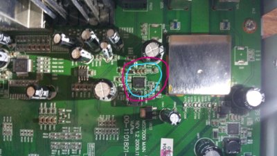

OK Replaced the CAP on the mainboard and the random booting has now stopped I hope.
The problem with the Tuner B I now think is the switching IC U808 on the mainboard an LNBH23L see photo
