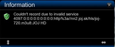

Hello .
is it possible to drive iptv record? on older versions it was ok. black hole has a hole .
