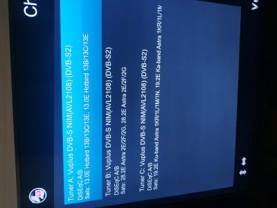

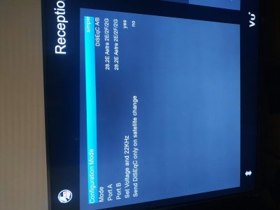

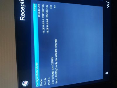

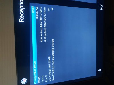

Thanks to you too, Mick, these are the configuration at the moment....Sorry for the pictures, I don't know how to put them straight...In each tuner there are 2 cables coming from the same LNB
IMG_20201110_134400.jpg IMG_20201110_134533.jpg IMG_20201110_134606.jpg IMG_20201110_134625.jpg
I would change it round, either put a cable from 19.2E, and 28.2E, into tuner A, and configure it accordingly, or 13E, and 28.2E, into tuner A, and similar mix ups with the other tuners, so you don't have the same satellite, connected to the same tuner.
Personally I would probably add another cable, from each Diseqc switch, and have all 3 satellites, connected to all 3 tuners.
Thank you, I cannot try now, but as soon as I will be able I will post the result

You need to be very precise and detailed. If you've got 2 cables from each LNB, and 3 tuners, the only way to watch/record/PiP/Stream at the same time from different transponders is to use 2 DiSEqC switches (with 4 output ports), one for each of the first two tuners: the 3rd cannot be useful for those LNBs.
If you connect two cables to same tuner you shouldn't be able to achieve what you would, as far as I know.
So, for instance, you need to set your 3x2 signals by:
Tuner A
Mode: DiSEqC A/B/C/D
Port A: 28,2E
Port B: 13E
Port C: 19,2
and tuner B in exactly the same way.
Tuner C is not needed, with LNBs equipped by 2 out. You may use it for another, distinct LNB, in case. But this is not needed with 4 out switches, because you still have another port free, at the moment.
The 3rd tuner will come useful only if you change your LNBs with 4 outputs ones. So, you'll buy a 3rd 4-port DiSEqC switch and connect it to the 3rd tuner.

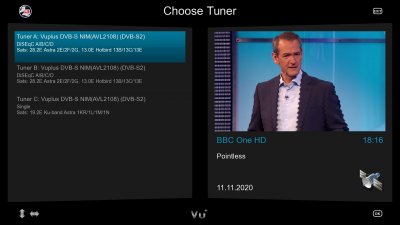

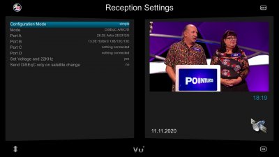

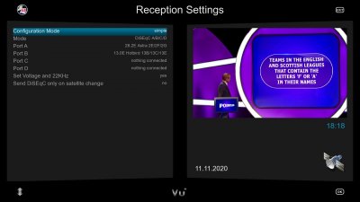

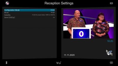

First check that both Astra 2, 28.2E, feeds are working, do this by only connecting the 28.2E cables into Tuner C, instead of your 19.2E, and set it up for single, 28.2E.
If they are both working, try connecting one to Tuner A, then the second to Tuner B, as single cables, and configure accordingly, then try recording, and viewing channels, on 28.2E.
Please post back with the results, and if both are working then we need to check the configuration, for the diseqc switches.
