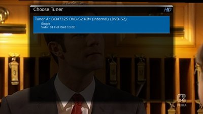

The DVB-S2 tuner has a very good performance . The channels that could be SD or HD, are always displayed rapidly, the signal is always stable and on high levels, and there are no problems of tuning failure or what so ever , that are instead some of the problems of competitors.​
tunersat.jpg​

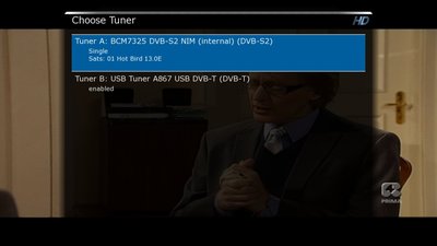

The USB digital terrestrial tuner is undoubtedly the most special feature in our vu + together with the blackhole. In addition to the classic inside tuner, we can assemble at any time on a external tuner using the usb slot of the decoder, by simply selecting from the menu the correct driver and installing it. The drivers for the tuner are developed constantly and are always created some new ones, thanks to constant Blackhole team that provides an impeccable functionality of this feature. Once you have installed the drivers, the USB tuner will appear in the menu as a common internal tuner, and we can proceed to search for channels. No mysterious disappearances of the sound, no delays, no problems. With Blackhole + Vu everything is as it should be, and the tuner works perfectly if it’s internal or external, and with the hardware decoders, we will be able to watch digital terrestrial channels in HD, even if the tuner that we will install does not provide tuning of digital terrestrial channels. It should be specified that the function of external USB tuner is not the only prerogative of Blackhole, but it is thanks to the Blackhole that we have the guarantee that it will work, the Blackhole team works with a lot of efforts so to ensure the maximum number of compatible devices and integrating them with extremely facility. In the screenshot in question I also installed an Avermedia A867.​
tunerdtt.jpg​

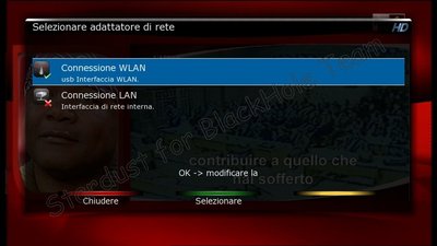

The network configuration is done not only through the classical LAN port, but also through wireless. Although vu+ does not have wireless lan inside, nothing is impossible: we can integrate it just like we do with the digital terrestrial tuners from the outside. We just insert a pen drive with a chip ZD1112 or RT73 compatible with Vu +, to obtain besides the classical panel for setting of LAN, another panel WLAN. Solution clearly preferred by all who have no chance of passing LAN cables, or who want to save money for the purchase of a power line adapter.​

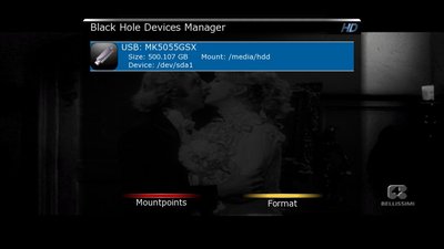

Vu+ Solo is not provide with the possibility of adding an internal hard disk, but this is not a problem. We can assemble at any time an usb hard disk, and again Blackhole will help us. The only thing we have to do in fact is enter the hard drive into a USB port, and from the panel devices manager, we will format the device and perform the mapping of it in / media / hdd. Within three minutes, our usb hard disk is installed and working perfectly! Without using uncomfortable ESATA that require additional power but more importantly spending more money being that the ESATA boxes are not easy to find as the USB protocol.​
mediahddverbatim.jpg​

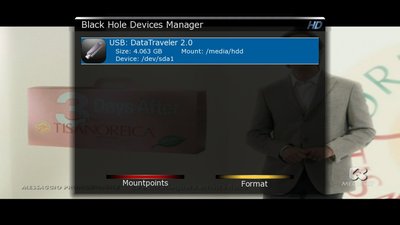

The versatility of blackhole with the panel manager devices will let us use simple pen drive as storage for our records, for example in the picture that is illustrated here I have used as a hard disk a 4GB pen drive. Therefore it is not strictly necessary to use a hard disk to store our records.​
mediahddpennina.jpg​

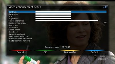

The picture and sound quality, is in line with the competitors, actually it should be pointed out that on Vu Plus you won’t have a low audio problem on HD channels, on the contrary, they have a perfectly aligned volume as sd. On the video we will have an infinite number of parameters, so we will be able to adjust the image to our taste.​

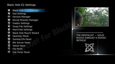

The wide blue panel allows us to access a big amount of options, whatever we want to do with our Vu +, we can do it. Cron manager, advanced devices, servers, samba, cifs server, nfs server, openvpn, usb tuner panel are just some example of what Vu +can offer as equipment with a team picture of the Blackhole.​

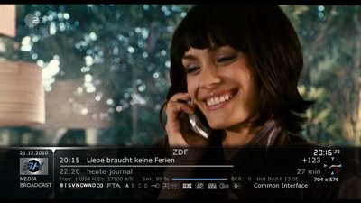

Of course with all this characteristic, an advanced screen graphics could not miss, that is the most interesting part of Enigma. We will see on screen all the information we want to know during the simple zapping. Resolution of the channel, the frequency, which coding are present on the channel, the program that is on air on that moment and the next one, the signal received by the satellite dish, from which satellite we're getting the signal, from which tuner we are viewing it and much, much more.​
osdm.jpg​

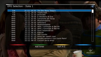

You can also receive weekly epg for all channels that we want, even for large providers, and unlike of other images, you will not need to install any external plugins. It 's all already integrated, and Blackhole is the only one on the square to provides such a service already built in.​
epgsett.jpg​
