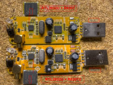

We have to be careful, according to what you have.
In the market you have RTL2832U + R820T
But you also have RTL2832U + R820T2, with 2 care, is another model not supported, it does not work.

No R820T2 tuner drivers just R820T
Try VTI image maybe they have a driver support in kernel for T2
I'm not sure about your receiver.
Abre el USB-TDT, foto, salimos de dudas en unos segundos/Open the USB-TDT, photo, we left doubts in a few seconds.
Ejemplo/Example:RTL2832U + R820T+R820T2.jpg
