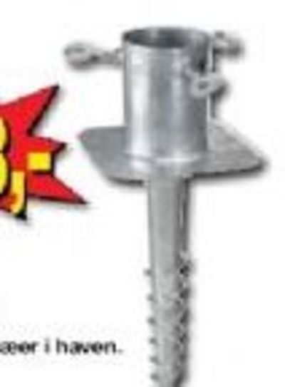

I use a christmas tree foot for fastening my dish, it is just 30cm above the sod
