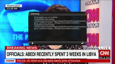

Guys I'm getting an error when trying to access plugins list, after installing serviceapp from feeds. It installed succesfully on my other solo2 last month. But now I get this error trying to install on another solo2 (both genuine).
Please see the attached screenshot.
Hi,
Try with Telnet, this command...
opkg update
opkg remove enigma2-plugin-extensions-serviceapp exteplayer3 ffmpeg
opkg install ffmpeg exteplayer3 enigma2-plugin-extensions-serviceapp
reboot
If don't work, try this fix...
mx3L said:
Hello,
I changed plugin name from enigma2-plugin-extensions-serviceapp to enigma2-plugin-systemplugins-serviceapp, also serviceapp is moved from plugin menu to system menu.
Please use this recipe to build:
https://github.com/mx3L/serviceapp/blob/master/enigma2-plugin-systemplugins-serviceapp.bb
If you already build enigma2-plugin-extensions-serviceapp,
then clean your sysroot with "MACHINE=yourmachine bitbake enigma2-plugin-extensions-serviceapp -c clean" and then build with
"MACHINE=yourmachine bitbake enigma2-plugin-systemplugins-serviceapp.
I will be not renaming plugin anymore.
https://forums.openpli.org/topic/41198-serviceapp-gstplayer-and-exteplayer3/page-17#entry601228
