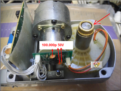

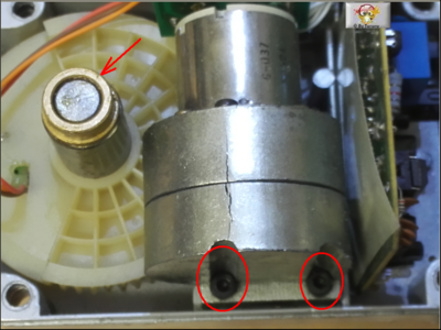

The original SG2100 (I have 2), dismantles and greases well inside.
The bronze cap sticks normally.

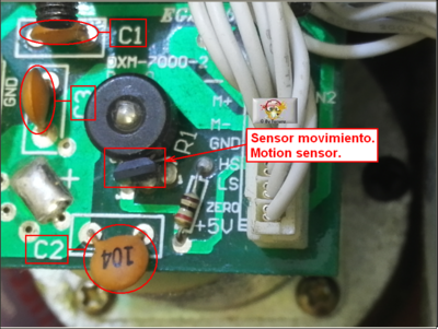

It changes the capacitors (100.000p 50V) that are around the sensor, they usually give problems over time.
If the motor does not rotate, it is normal for the protection to jump and the LED to turn red.
Photos of a clone similar to the SG2100.

Los SG2100 originales (tengo 2), desmonta y engrasa bien por dentro.
El casquillo de bronce se pega normalmente.
Cambia los condensadores (100.000p 50V)que estan alrededor del sensor all, suelen dar problemas con el tiempo.
Si el motor no gira, es normal que salte la proteccion y se ponga rojo el led.
Fotos de un clon similar al SG2100.
