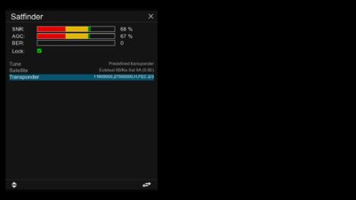

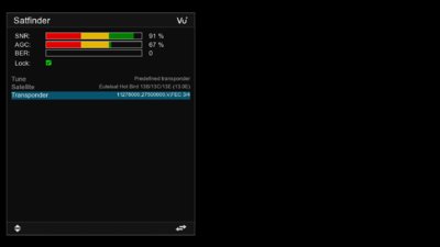

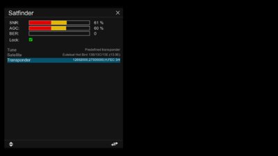

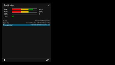

I've attached tests in the same conditions for comparison :
BLACK HOLE 3.0.5 (Vu+ Solo 4K ) :
BLACK HOLE 3.0.5 A (Vu+ Solo 4K ) :
Again I emphasize that the conditions are exactly the same with fixed dishes .

The question here is whether the established difference is cosmetic or real.
And that can only be tested on a very weak transponder.
Who knows maybe the cosmetic signal is weaker and in reality better,or the same.
