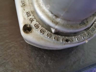

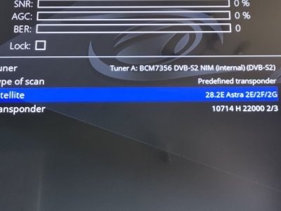

OK little update pulled the motor off reset it to 0 and motor itself but when using sat finder in image motor drive to over 30 just when pointing at 28.2 and long+lat set to 0 east 55 north and that's sitting on me living room floor nothing but motor connected starting to thing motor needs replaced

Motor goes to zero on the dial. So everything OK there just when moving I get this 10 degrees out.
Sorry trying different images just incase
Yes strange behavior.I don't know .
Try another image ,but if it's the same I'm afraid the motor isn't good
or cables.
Quick update after the day playing with this tried motor on multiple images and new cable same thing so I have set my long and lat to 0 east and 55 north and seem to be picking up a lot of Sat's will leave it there for now until something more breaks.
