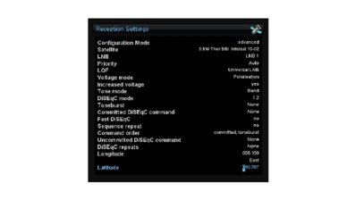

I am running BH 2.1.5 on a Solo2. Tuner-A is configured as a single satellite (Thor 0.8W). Tuner-B is connected to a Motek SG2100A Diseqc motor. No matter what commands I send to the Motek, it doesn't move. I have reset the motor according to the manual, but no joy. Even trying to manually move the motor via the Positioner menu gives no movement. I am not concerned about the signal, only to get the damn motor moving correctly! I am able to move the motor using the buttons underneath.

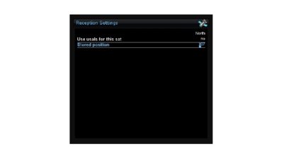

The Diseqc 1.2 positions are stored in the motor and not in the receiver. All the receiver does is tell the motor which Diseqc 1.2 position to go to. So now your motor is being told to go to Diseqc 1.2 position number 7, and since the motor does not have any information stored for position 7, it does nothing.
You have verified that the motor is connected to the receiver because you can move the motor manually, so we know the motor works. I suggest switching to USALS to get the motor to move close to where it should be. Then use the motor control menu that is available in the BlackHole Image to fine tune the signal, then store the position in number 7 or whatever number between 1 and 99 that you wish to use.

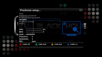

Go Here: Menu--->Setup--->Service Searching--->Positioner Setup
Then scroll down and highlight "Set limits". Then press the red remote button to turn limits Off. The motor should move using the receiver after you do this.
I pressed Red to remove the limts, but it's still not moving at all from the STB. Manual movement with the buttons is fine
The motor will not move using Diseqc 1.2 positions until you move the motor to the correct location and then store or save them in the receiver. Saving the correct Diseqc 1.2 positions in the receiver writes the location in the motor. You may use the manual buttons on the motor to move the dish to where it needs to be, then save the position in the receiver, or use USALS.
To use USALS, you need to enter the correct latitude and longitude for your area. In post number 1, the longitude and latitude have the image default positions, and it is doubtful that those numbers are correct for your location. The motor will not move using USALS unless the correct latitude and longitude is entered for your area.
