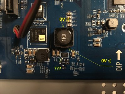

I have a problem with solo4k... he's dead
only the blue LED is on the front panel..
the IC U114, capacitors C265, C267, C270 and transistor U142 have been damaged
I desoldered the damaged IC because I do not have a new one
my solo does not start after soldering new ones C265,C267,c270
there is no voltage on usb and I don't know why
there is no voltage at the output of the IC U101 .MPEP 8762.
MPEP 8672 it is similar to MPS MP8762
in a typical application of MP8762 works when Enable pin EN is connected to IN through a pull-up resistor
In My solo4k is not connected to anything
I don't have a schematic or photos of the motherboard and I do not know if it should be like that
anyone help?
anyone help?
