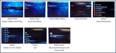

5) Mount your NAS as Root Directory
VU+ Main Menu > Setup > System > Select your network connection (WLAN or LAN)
6) Follow the picture quide to finalize the process: Kodi1.jpg and Kodi2.jpg
