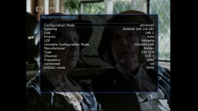

16e satellite not active channels in ch list and the name of sat not appear in the list sat name
i sent satellite .xml to solo2 bh 2.1 and sure the file is correct but the ch not active and i sure the tuner config is correct
need help to solve this problem
