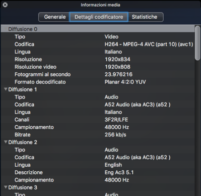

Here are the video info:
File: The Bourne Identity [BDRip-1080p-MultiLang-MultiSub.mkv
Format: Matroska/WebM file format
Chapters count: 20
Stream count: 21
Duration: 01:58:33
Bit rate: 9607 kb/s
Meta info:
creation_time: 2011-04-14 11:14:07
Stream 0
Type: video
Codec: h264
Codec profile: High
Width: 1920
Height: 808
Sample aspect ratio: 1:1
Display aspect ratio: 240:101
Pixel format: yuv420p
Frame rate: 23.98 fps
Default: YES
Meta info:
title: The Bourne Identity [BDRip 1080p][RiP By MaX]
language: ita
Stream 1
Type: audio
Codec: ac3
Bit rate: 256 kb/s
Sample rate: 48000 Hz
Sample format: s16
Channel: 6
Default: YES
Meta info:
title: Ita Ac3 5.1
language: ita
Stream 2
Type: audio
Codec: ac3
Bit rate: 256 kb/s
Sample format: s16
Channel: 6
Meta info:
title: Eng Ac3 5.1
language: eng

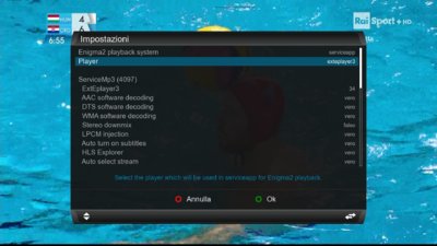

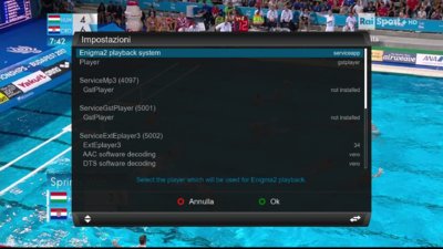

OK, I've installed serviceapps but, as the problem persists, I looked for any settings of this plugin but I didn't find any.
Hes is on BH 1.0 in Main Menu/System/Setup/Serviceaap
After push menu buthons in movie list you see 2 next option.
I dont know this help you but in my Uno4k work very fine and fast
I found it but the two options about Enigm2 playback system (apart from the "original") have not solved. I see
gstplayer
exteplayer3
but gstplayer says below it's not installed. How to install it?
