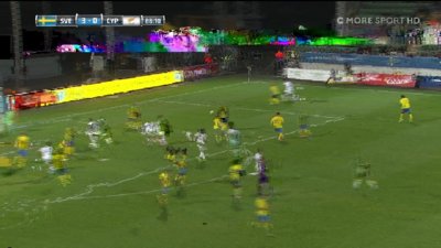

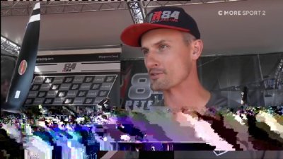

And about the "rain " i can say that the problems comes only when it rain "strange"
And only on some TPs
Tested on Ex. a weak satellit 75E and a weak HD channel (Telekanal 360 HD) No problem.
But on Ex. SVT 1 HD 0,8W and Cmore Sport HD bad picture.

Yes about DECT phone

It seams that it is some cable fault it works with my naebors
dish .
So now it is for me to see what the fault is .
