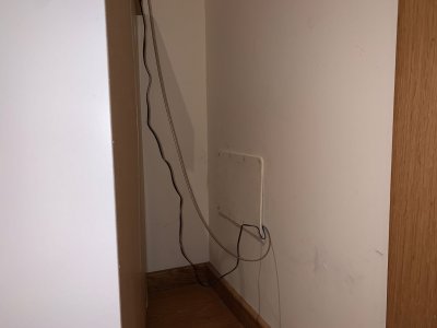

I am currently living in a rental house for about 10-13 months, until I have my home. In this house, due to the distribution it has, there is no socket next to the router, it is directly connected in the connection box and since it is not mine, I prefer not to touch anything... hahaha.
It is true that the Wi-Fi connection is quite slow, but I don't know why it is possible that I cannot have the Wi-Fi adapter and my USB-HDD connected at the same time.
