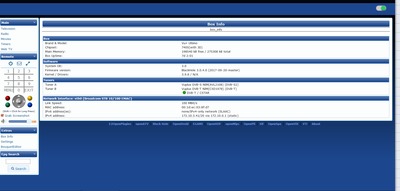

Just in case I include screenshot of typical config of my VU+ in that system !
