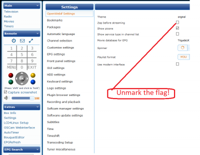

OBH 4.4.006 in a 4K Duo.
With the receiver turned on, tuned to channel x (on tv), we go to the PC and, through OpenWebif, we ask for streaming from channel y... immediately the receiver switches from channel x to channel y (which we ask for OpenWebif). If the receiver is off, it behaves normally.

Simple:
