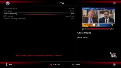

Did you solve? Are you sure you chose the right sync option like in the screen attached?

I am not quiet sure what is happening here. Yes the settings showed matched exactly my settings.
