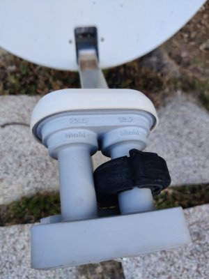

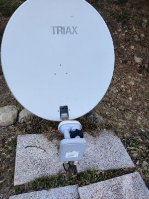

Can you please take a picture, of your dish/LNB and upload it to the forum?
Skochxx
This is what I've got. As I said, the other receiver we have in the house has channels from both 19.2 and 23.5, so the signal is being received by the dish.
Also, before all this trouble started, I did have reception of both sats on the VU+ box, but the box was frozen for whatever reason and the channels wouldn't change. This was the original problem.
So basically the signal from both sats should be coming into to the VU+ box, but for whatever reason the receiver can't see the 23.5E satellite, and only picks up a few channels from 19.2E
Mick12334
Moderator
That looks like a Monobloc LNB.

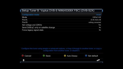

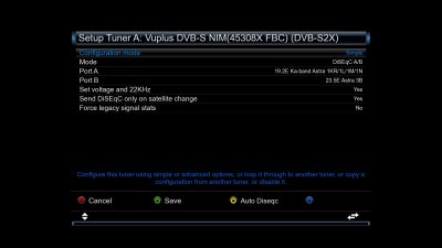

Skochxx
I have the following setup as far as the tuners are concerned:
Tuner A: Vuplus DVB-S NIM(4530X FBC) (DVB-S2X)
FBC socket 1 / DiSEqC A/B
Sats: 23.5 Astra 3B
TunerB: Vuplus DVB-S NIM(4530X FBC) (DVB-S2X)
not configured
FBC socket 2
I have no idea how to set Diseqc settings. The only thing I've been able to find on that is when I select Tuner Q, and then I can set "mode" to diseqc a/b or diseqc a/b/c/d, positioner, or toneburst.
There's also an auto diseqc option using the yellow button, and i've tried that several times but no effect.

Skochxx
Ok, I set Tuner A to Astra 1 19.2E and tuner B to astra 3, 23.5E.
Only 6 channels found on Tuner A, nothing found on Tuner B

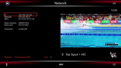

If you'll post the complete tuner configuration, we can have all the infos needed. Please: look for your box IP address under
MENU/Information/Network (like in the picture I attach) and the use your IP into a browser: for instance, in my case the IP is 192.168.100.222 and you'll type
192.168.100.222/grab
after, of course, recalling the menu with your Tuner A and then Tuner B configuration.
Such images in your browser can be save as every other pictures from a website (right click on the picture and save it..)
