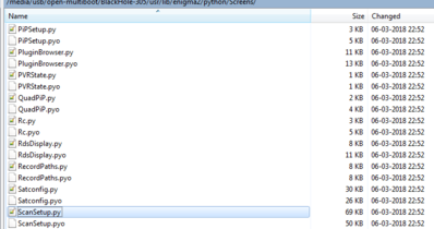

Imamgini in OpenMultiboot:
local:
/usr/lib/enigma/python/Screens/ScanSetup.py
  def createConfig(self, frontendData):
       defaultSat = {
         "orbpos": 192,
         "system": eDVBFrontendParametersSatellite.System_DVB_S,
         "frequency": 11836,
         "inversion": eDVBFrontendParametersSatellite.Inversion_Unknown,
         "symbolrate": 27500,
         "polarization": eDVBFrontendParametersSatellite.Polarisation_Horizontal,
         "fec": eDVBFrontendParametersSatellite.FEC_Auto,
         "fec_s2": eDVBFrontendParametersSatellite.FEC_9_10,
         "fec_s2x_qpsk": eDVBFrontendParametersSatellite.FEC_13_45,
         "fec_s2x_8psk": eDVBFrontendParametersSatellite.FEC_23_36,
         "fec_s2x_8apsk": eDVBFrontendParametersSatellite.FEC_5_9_L,
         "fec_s2x_16apsk": eDVBFrontendParametersSatellite.FEC_1_2_L,
         "fec_s2x_32apsk": eDVBFrontendParametersSatellite.FEC_2_3_L,
         "modulation": eDVBFrontendParametersSatellite.Modulation_QPSK,
         "modulation_s2x": eDVBFrontendParametersSatellite.Modulation_QPSK,
         "is_id": -1,
         "pls_mode": eDVBFrontendParametersSatellite.PLS_Unknown,
         "pls_code": 0 }
Non sai come aprirlo o non lo trovi? E' un file di testo: qualsiasi editor di testo lo apre.
Se invece non lo trovi è perché il percorso sopra contiene un piccolo errore. Il percorso è:
/usr/lib/enigma2/python/Screens
