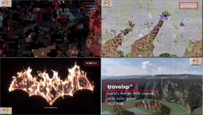

Both Travelxp 4k and C4k360 on hotbird were working fine a few days ago on my Vu Uno 4k but it appears these channels are testing HLG HDR 4K transmission and the video is now flickering and freezing. Any solution? Regards

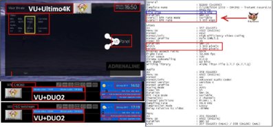

Unfortunately, I don't have another 4k receiver at the moment. The picture becomes normal when the channel stops testing of HLG HDR broadcast and resumes normal service.
VU+Ultimo4K.

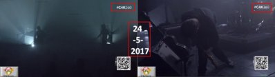

Of course, the C4K360 channel is seen with many pauses (blinking and freezing) or straight away turns black.
This week I reviewed Hot Bird 4K channels for the name change Travelxp 4k that has me crazy and all OK, but now with the problem commented on channel C4K360.
Make a recording of 1 minute, on the PC looks good, I look at the recording on the receiver and looks good too.
Being in the channel, if you have hard disk, pause and then continue, now you will see well, without the freezes / pauses, audio ok.
They are playing something in the broadcast and the receiver does not like it.

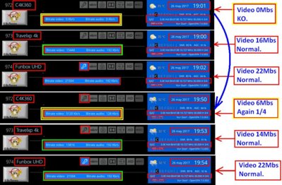

Typically the C4K360 channel has a BitRate of 16Mbs-21Mbs.
It is now 11.8Mbs, maximum 14Mbs.
Looking at the characteristics of 1 minute recorded, nor 6Mbs.
Megas are missing everywhere.
Travelxp 4k is with the same "trick".

18:45 GMT+2.
C4K360
.- Black, has no video (0) or audio (0) at the moment.
Funbox UHD .- As always, BitRate video 21300Kbs and audio 192kbs.
Travelxp 4k .- This normal as before the tests according to memory, peaks of 18Mbs, average 14Mbs.
In the mornings he retrieves the name, in the evenings he loses it, I have it renowned so that it does not disturb.
C4K360 boosted again to 1/4 of BitRate, peak of 7Mbs 19:45 (GMT+2)
With the trick (pause 2 times) OK.
Travelxp 4k keeps the BitRate normal, does not need the trick (pause / pause) .
Photo at 19:00, about 19:45 I started C4K360.
18:45 GMT+2.
