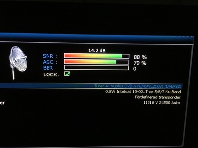

Open PLI was installed on it and trying to just getting it to work first.... cant find a single channel... using 0.8w Imsat /Thor and 4.8E Astra.... withc band shuld i use.. C, Ku or Ka?

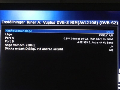

I have 2 dual LNB's and 2 Diseqc switches..
the cabels is in the top connector'son the Ultimo marked "LNB IN"

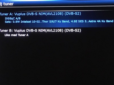

How have you configured your tuners?
With just two LNB's, and Diseqc switches, you should have them set up as Simple, Diseqc A,B and select the appropriate satellites.
Please post back with your settings.
Are your Disecq switches 2x connections, 2 in one out, 4x connections, 4 in one out, or other?
Try setting Tuner B to Diseqc A, B, or A, B, C, D, depending on your Diseqc set up.

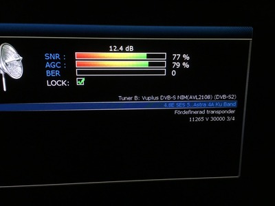

If possible also try running a direct cable, from one LNB, to your receiver, then set up your tuner to Single, select the satellite and try a blind scan.
What are your signal quality readings?
Have you tried manually scanning in some HD channels?

You probably have Open Pli installed, go into the menu, look for About, or Information, which should provide more information.
Also scroll down to predefined transponder, on 0.8W, and try changing it to User Defined Transponder, select DVB-S2, and enter 10778 V 25000, and check the signal quality readings.
