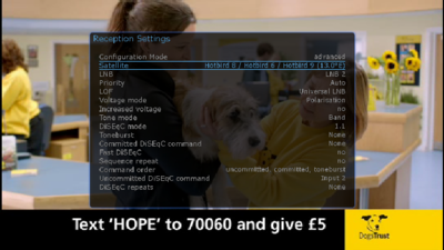

After flashing UNO with OpenBlackHole-0.1-vuuno_usb_nightly_20150619_78a407f , i keep getting "tune failed" at some channels... Reception setting menu in new software is changed and i suppose that is where it went wrong... Here, some images of configuration in old software - BlackHole-2.1.6-vuuno_usb_release_20150521_6404c21:dreamDroid_1388832514525.png Besides Hotbird, there are four more lnbs in use: 16, 19.2, 23.5 and 28.2. and all worked well.
...And this is how i configured it in OBH:screenshot.jpgWhat's wrong?! plz help, anyone.....
After flashing UNO with OpenBlackHole-0.1-vuuno_usb_nightly_20150619_78a407f , i keep getting "tune failed" at some channels... Reception setting menu in new software is changed and i suppose that is where it went wrong... Here, some images of configuration in old software - BlackHole-2.1.6-vuuno_usb_release_20150521_6404c21:View attachment 23958 Besides Hotbird, there are four more lnbs in use: 16, 19.2, 23.5 and 28.2. and all worked well.
...And this is how i configured it in OBH:View attachment 23959What's wrong?! plz help, anyone.....

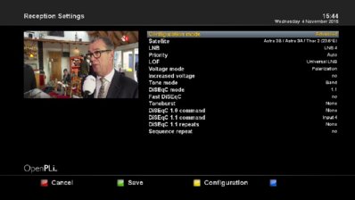

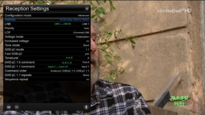

Try this config ...
I have only 2 diseqc positions, you can adapt it to your configuration.
First sat position ( see the screen shot .. ) Astra 19.2 East
Snd sat position ( see the screen shot .. ) Hotbird 13º East
Compare it, and adapt to that one that match your settings.
