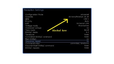

Hi, when I update the channels through vhannibal, or I do a backup of the channels, the tuner remains blocked on the satellite astra 28 is, how to solve this problem and thank you

I have to use Advanced mode, and Diseqc 1.2, as I have a 36v motor and a V-BoxII setup.
Is your satellite system similar?
i am using Openblackhole
i have a Vu+ solo2
i have a motorised dish
yes i have to use advanced mode and diseqc 1.2 ....
Note: This is the first time that it happens to me and right on openblackhole, but when I use Blackhole, everything works well

Personally I would back up the channel list, currently on your receiver, using dreamboxedit, re-flash with Open blackhole, set up your tuners, than load the saved channel list.
This will help solve where the problem lies.
Goto http://satellites-xml.eu/ download a full sat xml for all sats and all channel types.
telnet to your box and issue command init 4 then ftp the new sat.xml to etc/tuxbox making sure to overwrite the old one the best way is to first rename the original file to satellites.xml-old.
once you have the new sat xml on the box go back to telnet and issue command init 6 or type reboot.
