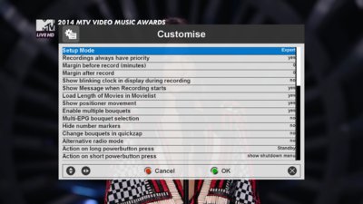

Go to customise settings via menu -> setup -> expand to expert MENU
Yes, it is exactly where I set the priority preferences choosing C or A as I wrote above.
But both choices don't lead to the desired result. As I wrote:
1) If I choose C, VU+ uses C for terrestrial and B for sat and not A
2) If I choose A, VU+ uses A for sat but D for terrestrial...
