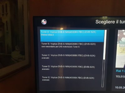

hi I entered mutistream tuner, I set the tuner as motorized but I have no signal where I got it wrong thanks for the answer
