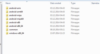

Android NDK to the rescue. :)
The NDK have alot of prebuild targets, including mips x86/x64
found in the prebuild folder.
dC6ud8I.png?1

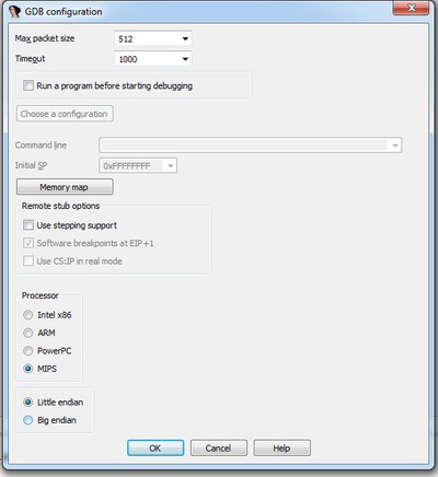

well mips is mips, gonna try the android mips x86.( im cheating i allready knew what my target is)
i have upload all the targets here
https://mega.co.nz/#!H90zHTLJ!ht96FhUqZdEohW_rx3x8_Js51-HVpsuVEDObhSN0ccc

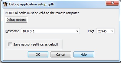

now we connect to box.
i use putty, but you can use windows telnet also but you have to activate it.
after username and password we have telnet shell.

we try open 23946 port
we try both cases
ssh -L 23946:10.0.0.41:23946

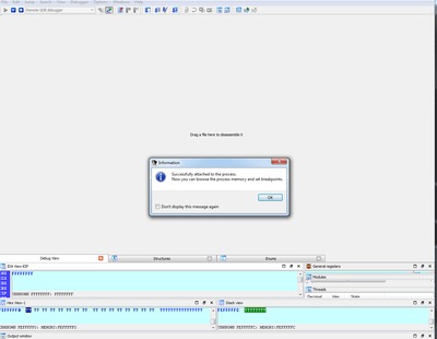

Okay looks like its open.

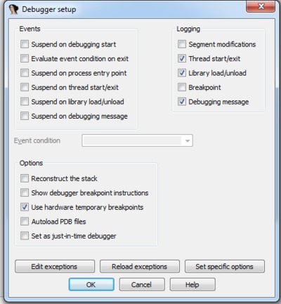

now fire up ida i use with admin rights.
goto debugger >> attach remote GDB server.
select Debug options and then set spesific options
6sguLnt.png?2
in spesific options choose mips architecture..
T0RgkV1.png?1
press ok ok ok

GJkmxTQ.png?1
i had local ip 10.0.0.1
we go along press ok
it then ask what PID to attach to.
ORkS4VS.png?1
we have pid running before with the ps commands.
use any pid you want to
success
tIUMWoX.png?1
:D
