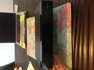

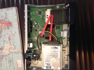

Post the photos of your STB:
  • Front
  • Up cover
  • Back of STB
Front back and internal. Hope these are clear enough for you.

Have you contacted your supplier, explained the problem, and asked if he can confirm that the receiver is genuine?
