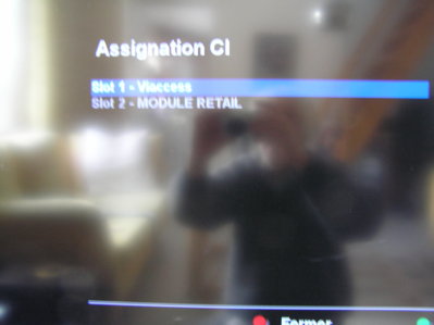

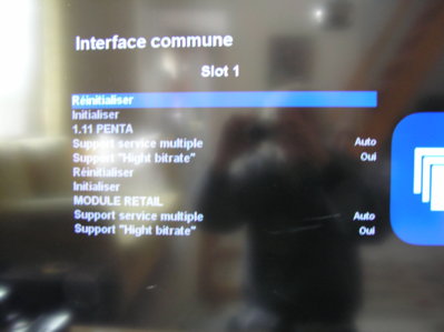

hello
the first cam module is viacess icecrypt slot 1 cart inside Biss tv for the other cam module I have try 4 differents type : viacess icecrypt, viacess red, mediagard 1.4 and magic module at last this the problem when you have 1 ca module with smartcart inside it work but if you insert the second ca module without cart or with cart viacess or conax you lose the thirst
Ca module working no more decrypt
this some picture
hello
As I wrote before, IMHO 2 Viaccess CI modules at the same time can't be inserted and used for decrypting.
And personally I don't know an Enigma2 receiver that can do that (but it might exist).
