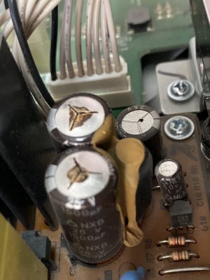

Yes: bring it to a technician as, almost certainly, it has got some capacitors blown up.
And, if it's not due to capacitors, is 99% a HW problem.

As I said, 99% is a HW failure, almost certainly due to blown up capacitors.
And, by the way, if flashing is not possible and every SW-side attempt fails, there is no other way than taking it to a technician.
Do you see, for instance, some capacitors that look like the one attached?

Not possibile.
the box is too recent. if hardware failure breaks the Motherboard

No, I have opened it and I do not see any swollen capacitor or some component in bad condition, same problem that this user:
