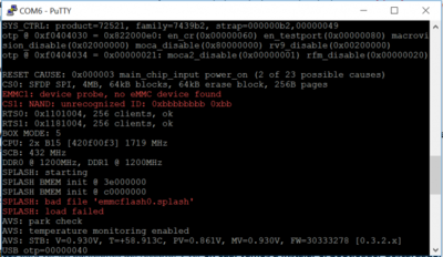

Hello, i tried to flash an image to Vu+ UNO 4K SE and i bricked the device.
Accesing by rs232 console i get this:
BOLT> show devices
Device Name          Description
              uart0  16550 DUART at 0xf040a900 channel 0
               mem0  Memory
        flash0.bolt  SPI flash @ CS0: 0x00000000-0x00200000 (2048KB)
      flash0.macadr  SPI flash @ CS0: 0x00200000-0x00210000 (64KB)
       flash0.nvram  SPI flash @ CS0: 0x00210000-0x00220000 (64KB)
     flash0.devtree  SPI flash @ CS0: 0x00220000-0x00230000 (64KB)
             flash0  SPI flash @ CS0: 0x00000000-0x00400000 (4MB)
               eth0  GENET Internal Ethernet at 0xf0b00000
              mdio0  GENET MDIO at 0xf0b00800
              sata0  SATA3 AHCI Device
            uart_b0  16550 DUART B at 0xf040a980 channel 0
           usbdisk0  USB Disk unit 0
       tcpfastboot0  TCP Fastboot (port 1234)
        tcpconsole0  TCP Console (port 23)
*** command status = 0
Any solution to this problem?
Thanks!
If really every attemps fail, it's probably a hw failure for the flash memory.
But, before saying it, try several USB stick, partitioned and formatted as explained in our guides.
