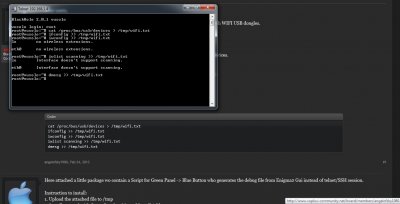

Been following the guide, but I'm getting a problem.
When I connect via Telnet, and type in all those commands, it comes up with 'no wireless extensions' and 'Interface doesn't support scanning'.
I have attached a screengrab of the problem. Any ideas?
I typed in iwconfig and it says that my Wifi dongle is a 'RT2870STA'. Is this supported with Blackhole 2.0.1?

Read CAREFULLY my support post.
It's clearly reported that these command generates a file into /tmp folder of your box.
This file is NEEDED to understand what mean on your box.
Catch the file from your box and upload it.
