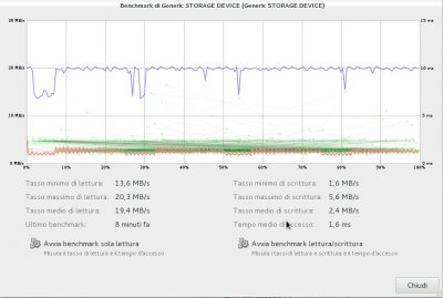

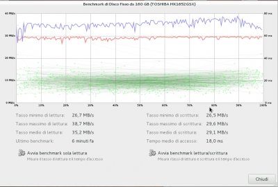

for a curiosity i have tested just now the 2 devices with my pc:
the flash one (emtec 8gb)
and the hd one a toshiba 2,5" 160gb in a usb case adapter
i thinked about a similar speed, but with the benchs are 2 different worlds
(on the left the reading speeds, on the right the writing speed)
