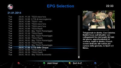

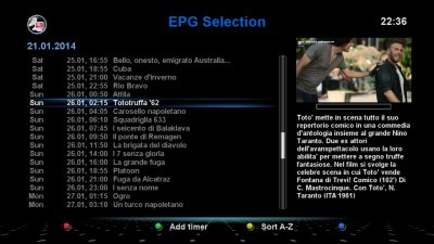

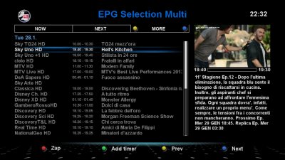

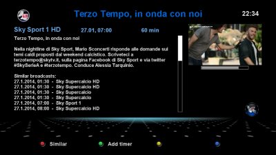

Which Sky ?
Italy
I have test Open EPG download from transponder epg channel for 7 days
I used CrossEpg open Epg download
Maybe not with complete extended description for all channles
but it is a problem from the provider
but I have 7 days epg
For Rytec internet XMLTV servers epg im not sure if he is working in this moment.
I think this is servers and not image problem

As you can see from the CrossEPG log
downloading from the XMLTV EPG server also works.
( Try before download to update XMLTV/xepgdb providers in CrossEpg panel)
The only question is how good is EPG
But it has nothing to do with the BH image
