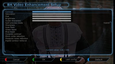

Menu>Setup>System>Video Enhancement...

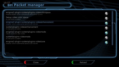

Use pocket managements!
To install\uninstall the plugin!
long press blue>software managements>>advance>>>Packet managements
thanks mate tried that . when i long press blue button all i get is a list of extensions I've found software management in the menu's but there's no advanced ?

Mate, Video Enhancement is a part of BH image. You can't install/uninstall it by Software Manager.
Did you try that?
Yes My friend I'm aware of where it should be in the menu's and what it looks like but what I'm trying to get you to understand is that since i upgraded to BH 2.0.4 i have not been able to access video enhancement in any way i cannot find it ?

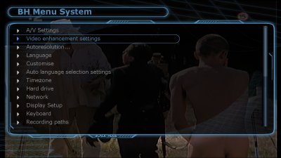

Mate go to menu>system>customise. Then setup mode to expert. Press green. Go to software management then
that worked thank you yummer and to all who helped after 10 mins of scrolling through the list i found it re-activated it and all is sweet
