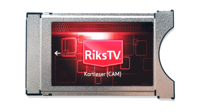

Hi,
I recently bought a VU+ duo 2 and have installed BH. The setup works well on FTA channels.
My provider is the norwegian company RiksTV , broadcasting on DVB-T. I have installed a Strong CA module and the smartcard is inserted in this unit.
When watching CA channels the image freezes after 5-15 minutes and the unit becomes unresponsive to the remote control. The only action that works is to power off the unit with the swith at the back of the unit.
There does not seem to be any crash log generated, and I have not been able to find anything in the debug log. I have also tried VIX and am experiencing the same issue.
Anyone got some advice on what could be causing this?
Edit: the CAM module is Strong CNX1660

I just left the unit running on an FTA channel and noticed it also crashes on this channel. CAM module was not installed so it seems the issue is not related to the CAM module after all.. any idea on how to trubleshoot?
